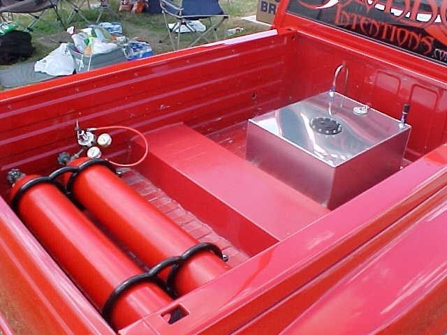

im gonna bag my 90 reg. cab f/s and wanted to know if i could raise the tank any. or could i lay on it and not drag. or do i get a fuel cell or put the stock one in the bed.

I know devious makes a different tank that sucks up, but thats for s10's. I drug though the plastic, then i bodydroped it, so you can make anything work but for the time and fab wise, put the tank in the bed, then down the road get a fuel cell, but remember you gotta get a aux fuel pump when you get a fuel cell, I run a holly blue, cause it has the right GPM you need for the TBI.

Just put it in the bed...It worked for me
I run the Holley Blue Pump like Dave said above.
Then I made it all pretty.
