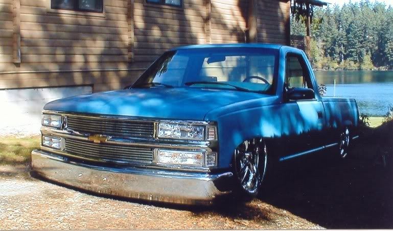

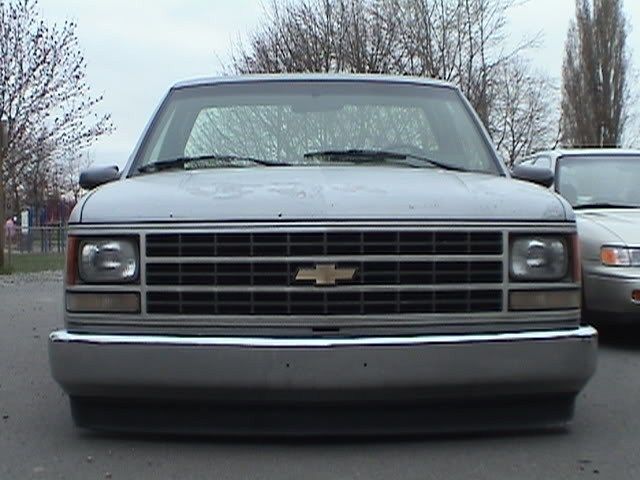

i have a 94 fullsize with the old farm truck sealed beam headlight. I want to change my front end to the newer 94-98 gmc/chevy front... i know i can keep my fenders and hood, and aside from the obvious headlights, signals, corners, and grill, Will I need to replace my header panel/radiator support? thanks,
from this:

from this:
to this:

you can use the same rad suport it all bolts on

sweet so i just have to convert from seal beams to regular, and bolt on the lights and grille...right?

right. youll need to do some wring to

you will also need the bumper filler(peice between the grille and the bumper). ckresto.com offers a complete conversion kit

you might want new bumber brakets to it makes the bumber sit out farther i left mine tucked back
