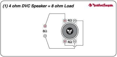

Option 1. wire 1 single voice coil(SVC) sub to the left channel and the other single voice coil to the right channel. THen wire your Dual voice coil (DVC)in series and then bridge it to the amp.
Series

if 2 svc @ 4ohm, wire in series to get 8 ohm. then wire (if you have 4ohm)your dvc in series to 8 ohm and then bridge the lead from your 2 svc's in paralell to the lead from your 8 ohm'ed dvc to your amp to present a 4ohm bridged load. your amp will see the draw from one channel but i still dont advise to do this.
