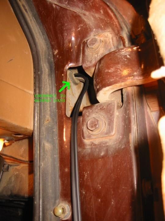

what you guys are referring to are jeep wagoneer door hinges....they are plenty strong for any other truck door..and yeah the are just like suicide hinges u buy....
Big Rik's avatar
Big Rik

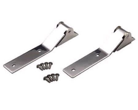

Wagoneer Hinges (for main doors)
Wrangler Tailgate Hinges
