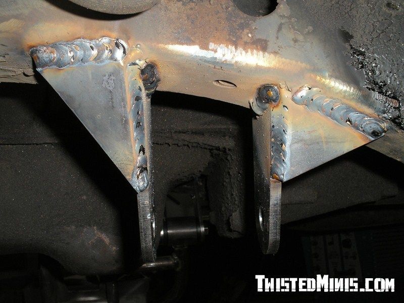

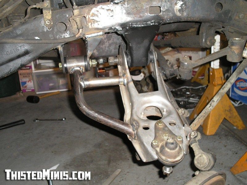

I'm having some nice issues with the pitman arm hitting the strut rod and holding the front up. I'm on 16" Z71s right now and not even bagged yet. Anybody have any pics of how they remedied this problem on theirs?
Minitucking's avatar
Minitucking
Drop spindles.
TwistedMinis's avatar
TwistedMinis
Works great.
Minitucking

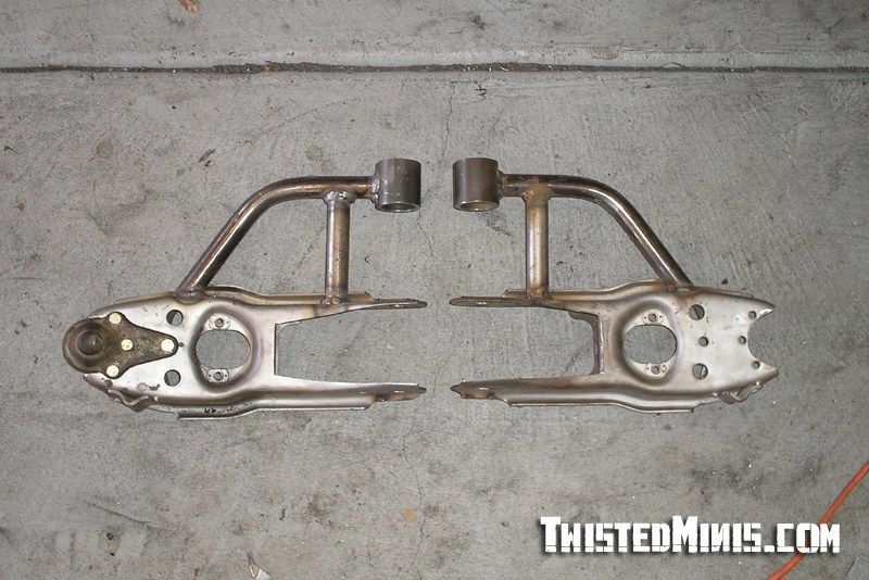

Damn Seth your reply was better LOL.. I like how you did that though.. gonna have to redo mine now or just make some lower control arms.
