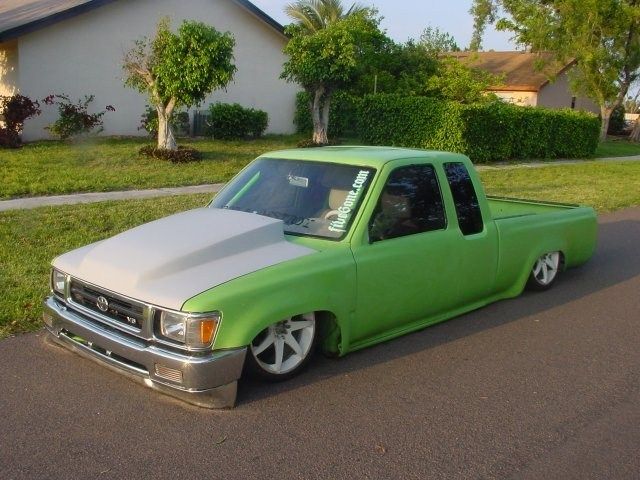

lowestyota
I did mine. We used 7 pieces to do the entire raise of the hood because my strut mounts were raised along with the engine
dragn4door's avatar
dragn4door
That looks like alot of work to raise the entire hood like that, came out good though. I can buy a cowl hood for my car but I don't want to fork out the $650 - $800 bucks for one. I will give the fabricating one a shot and if it don't turn out like I want it to then I'll go back to a stock hood.
