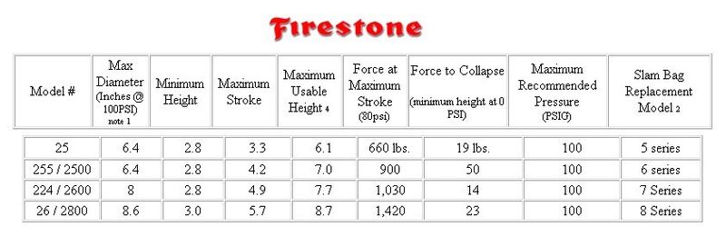

I need to know the dimensions inflated and deflated of 2600 and 2500 # bags.

look at slamspecialties.com under COMPARE it tells you all that good stuff.

I have airlift 2600 lbs in the rear of my truck, is it truck if I switch them over to slam specialties I will get several more inches of lift? The slamspecialties website has the firestones listed at about 8 inch inflated, which i am guessing is close to mine and the slams at 11? so 3 more inches? Let me know the experiences you guys and gals have had!

yes its true. and they ride better too in my opinion.
