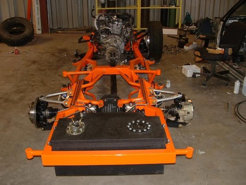

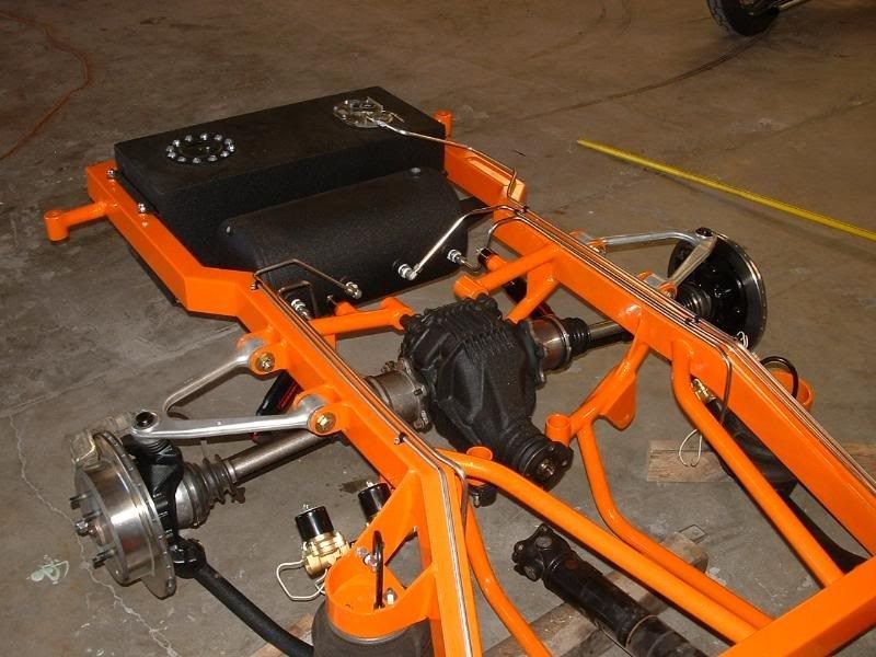

I was looking for pics of that Orange frame the other day. Does that guy still have a profile?
You can pic up a supra rearend for about the same price. It probably wouldn't cost that much to have the shafts cut and welded as opposed to having new shafts machined.

For all the work you would be putting into it, I don't know of many people that would bother using the crossmember. All the Supra rearends I've seen in trucks are setup similar to that orange frame. Do you know what the width is on a Mazda Miata?
