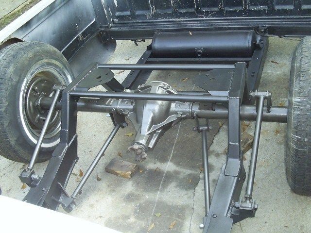

I'm looking into buying a 1970 c10 and was curious what to use to bag the rear. i was told 4 link would be the best. who sells one that fits or maybe a universal?

Air Ride has a set up in there new catalog.. if you have a coil spring truck
ARR21800-LCA 68-72 C10 lower rear STRONGARMS /w CoolRide kit $1699
ARR21800-LCA 68-72 C10 lower rear STRONGARMS /w ShockWave kit $2299

i would just rplace to coils with bags and notch it, cheap, and easy. you basically already have a big two link, just pu some bags on the bars.

When I first bagged mine I just got a bridge from suicidedoors.com that came with the bag over axle brackets. I moved the trailing arms in so they would clear the frame then made the panhard bar longer. It was cheap and easy for my first bag job and now I'm running the SD superlift 4 link.

ok if u put the bags on the factory trail'n arms ur about a mile away from lay'n if u go any bigger than 17's with tiny tires

the reason I asked was casue the rh trailing arm has a BIG ass hole in the center. Very unsafe if you know what I mean!

I can sale you and pete and jakes 4-link for 275.00 plus shipping.Best 4-link on the market in my opinon.
