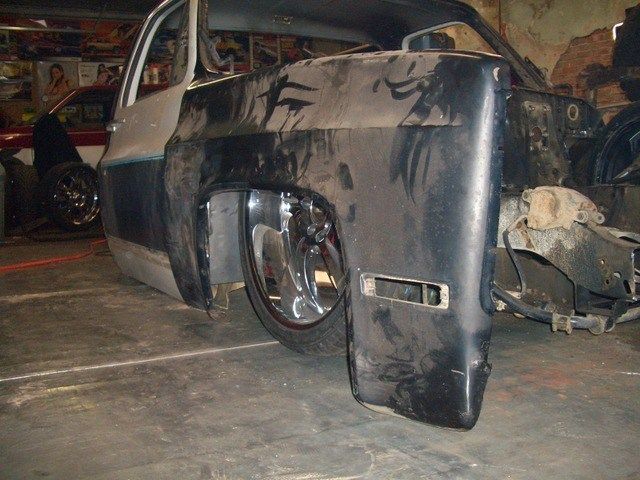

Does anyone know if this is possible with standard backspacing wheels on the 24s or will it hit the bed or will i have to narrow my rearend.
DragNasty
With a standard offset 24 you will have to narrow the rear end due to the the way that
the body rolls in towards the top of the bed.

Thats what i figured, thanks for the feedback
1SIC84
here is my buddy's truck doored on 23's all the way around...
