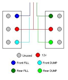

hey guys im using 2 6 prong swithches for a basic up down air kit does anyone have a wiring diagram on a 6 pong switch? also having trouble with my relay working i have everything wired up as the diagram shows but the compressor want turn on?

Hope that helps.. Drew it up in Paint real fast.
I replied also over on MBS in case the pic would help anyone else.
