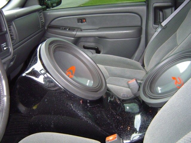

My box is already built go on my profile and look. I want to port it by cutting the back out and do the port under the back seat. Now the people i deal with when it comes to audio told the would do it and put it under the back seat like i said. My box is 2.5 cubic feet roughly. Now could you give me help on how to build the port?

i would leave it sealed, i dont think you have enough airspace(minus pot displacement and speaker displacement) to make it a ported box and have it perform better then your current setup.

Leve it sealed. You would be able to get away with just having one 12 in a box @ 2.5 but definatly not 2.

yea and for him to have a big enough port he would loose significant airspace.

annney ways he would need 4-5'^3 inorder to be able to make a decent sounding ported box.
