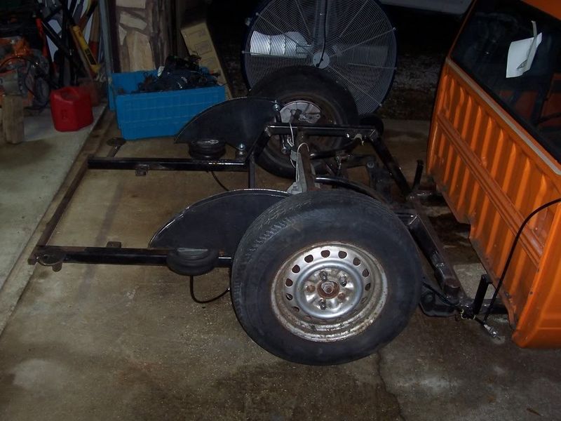

oddly enuff i had a canitlever setup on my 720 w. a rx7 irs.....this is an old pic & not very good but u can get the idea
i took it off bcuz i narrowed the irs so it would tuck

thats sweet man wish youy had a better pic though
/7
///RELAXED 720
what would u like to know about it ?

How much did you shorten it?
