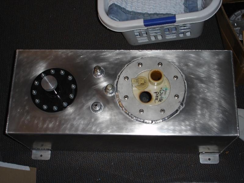

Hey all. Gonna be putting a fuel cell in a 94 Ram V8 with a 5.2. What all do I need as far as the external fuel pump and do I need a regulator? Also if you could recommend any type/brand/style of fuel pump/regulator and best place to get it I'd appreciate it! Thanks for the help!

you will need a regulator.i havve a barry grant regulator on mine along with holley fuel pump.
ramslam1998
Just cut the factory unit from the old tank and graft it into the fuel cell it works fine

maybe im not seeing something..but incase that pump goes bad which is common....how would u get that pump out to replace with a new one?

you take out the bolts on the retainer ring on the top and then pull the pump out. its not welded in solid, just clamped in with that top plate and like 10 ss cap screws.
