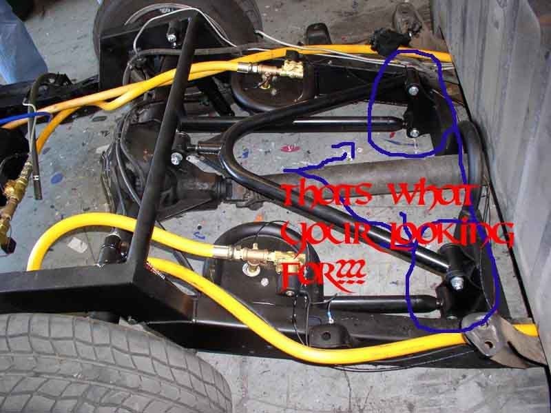

THIS ONES MINE
Pancho's avatar
Pancho
IGNOR THE RED TEXT

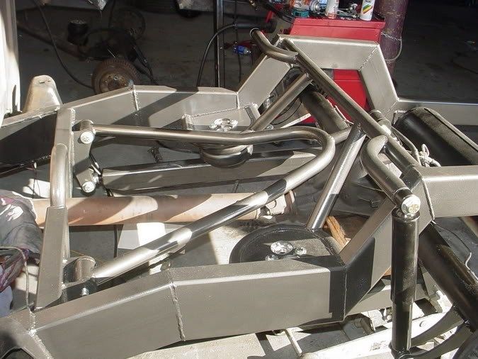

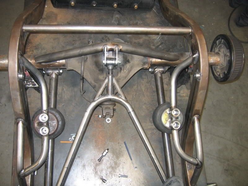

TwistedMinis's avatar
TwistedMinis
Heres mine.Essentially you're doing the same thing in a different location. So it will work.
