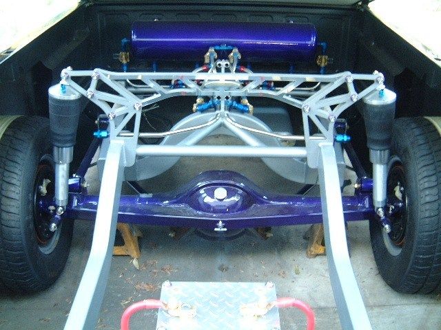

Whats you opinions on them?
how much travel do they get, etc...

not much travel although this depends on how you mount it- a lever setup will get you tons, but excellent ride...i got the dual adjustables on my dime and i ride at 100psi which is about 1 in from the fender wells and i got it to where i dont get any rub cause the of the shock valving, the only time it rubs is going over big bumps on the highway

yeah i guess it just depends where its mounted in relation to the pivot.
My friend has them on his s10 and he doesn't care much for the ride quality.
Im just trying to figure if I wanna go with them for my IRS or just use bags (i've got the bags already, frame is built.... its just not bagged yet.

I baught them for my 48 pickup and ended up swapping them for a standard slam bag setup through Jason. The shockwaves looked nice, but had crappy lift. I wouldnt use them on anything but a trailer queen, or a truck that wasnt that low at 0 psi.

I put them on a '03 extreme. They work great, super ride and around 5" travel with the a.r.t. uper and lower arms.

Their absoultly awesome. I got 8.5 inches of lift with mine, they dont list the shockwave i had on ART site anymore, but you can still order them, you have to call and ask about them. They have an 8.5 inch stroke, in the 9000 series. Ride is amazing, just have to adjust the shock to your prefered setting.

I got the 9000's mounted 1:1. Plenty of lift.
