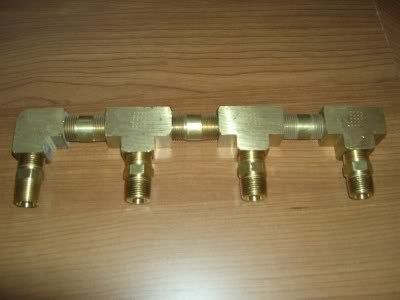

get 3 female t's. screw them together with nipples with a 90 at the end. out of each t, screw you in another nipple that goes into your valve.you only have to have 1 line to supply air to your valves this way. This works if you want your valves all in one place.
