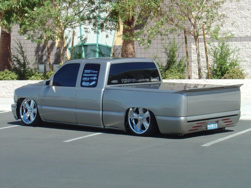

IM TUCKIN 20'S ABOUT TO UPGRADE BUT I DONT KNOW IF THE OFFSET IS RIGHT ON THESE NEW RIMS WILL 6x139.7+15MM OFFSET 22x9.5 108cb TUCK ON MY 00 SILVERADO

im going to have to say no they will not tuck. i could be wrong but im thinking im not.

I put 22's x 9.5 on my 99 silverado but I had to shorten my rearend 4 inches and I had to move a whole lot of stuff up in the engine compartment like the radiator overflow, battery, and electrical.-rj

no,rear doesnt tuck, im runnin 22x9 with a +50mm.

ok some one said about gettin a shortened rear end which is fine but how will i come about gettin it narrowed. and for the front what will i most likely have to move or lose

or what about bowing out the bed an inch or 2

I am wanting to know the same thing. The cheapest way to tuck 22's on a daily driver. I have a 4/6 drop. What is the cost on narrowing rearend (approx)?

Whats up fella's, no 22x9.5 with that offset isnt gonna tuck. Your either gonna need to shorten the rear end (i had to do the same thing with my dakota) or your gonna have to do billets !We're a direct dealer for Billet Accessories Direct and we can set you up with a killer price on a set of 22x8.5 billets, shoot me a email an i'll gladly help you guys out but we're direct with over 40 wheel companies so trust me thats not your only option

yes it does tuck u need to trim wheel wells, i rolled stock wheel wells for half a year it is really close, tubs and puttin longer braces forcing the fender out helps alot
