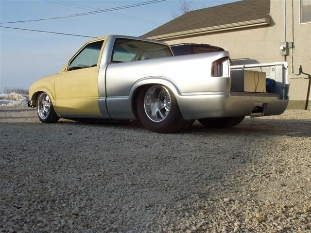

my buddy has 31/18.5s on 17x14 Intros on his S10 with a narrowed ford 9".
If you can find a billet wheel you might be able to get a custom offset for the wide tires to clear. But i would think about narrowing the rear, or building a narrowed 9" if you are gonna be putting down some power.

wow what kinda motor is in that s10??
just shorten your stock rear end and run your suspension inside the frame if you wanna run a deep wheel on it.
