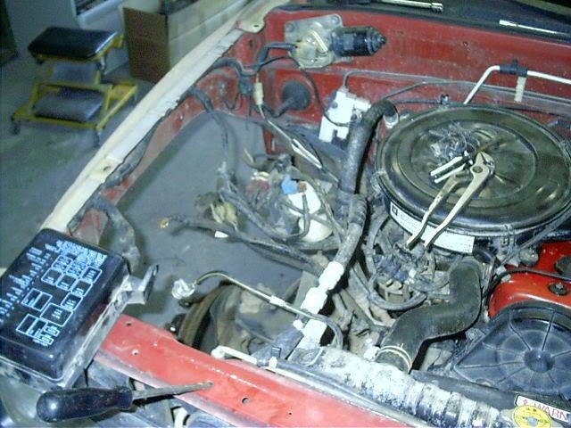

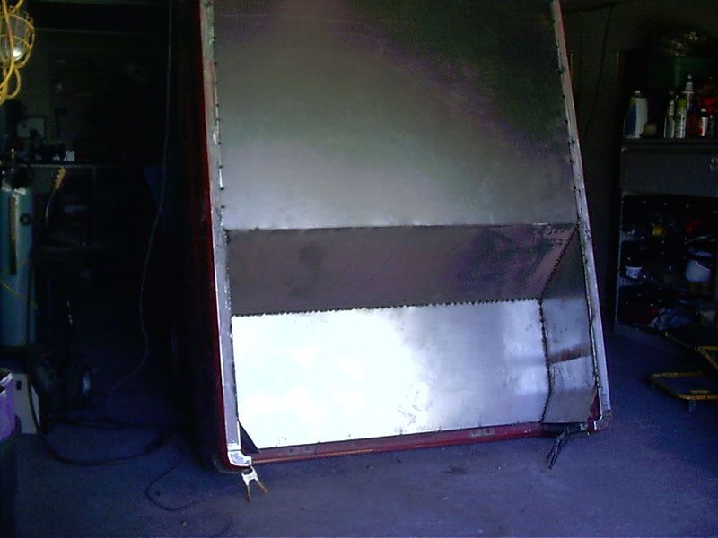

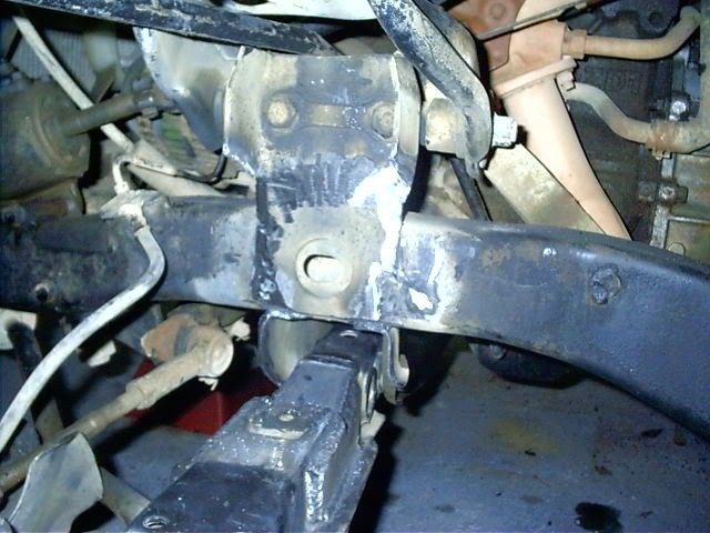

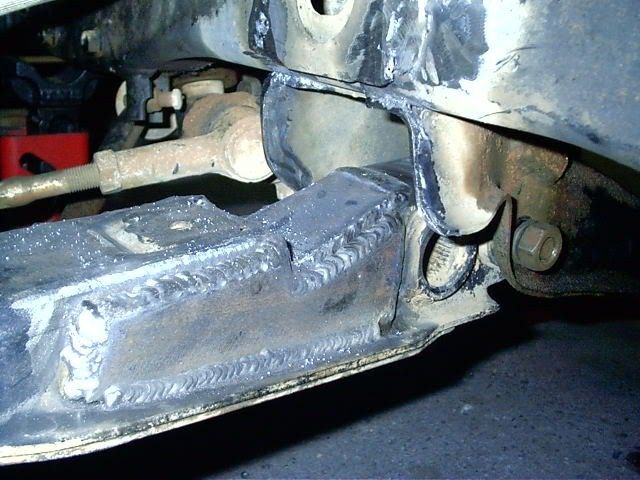

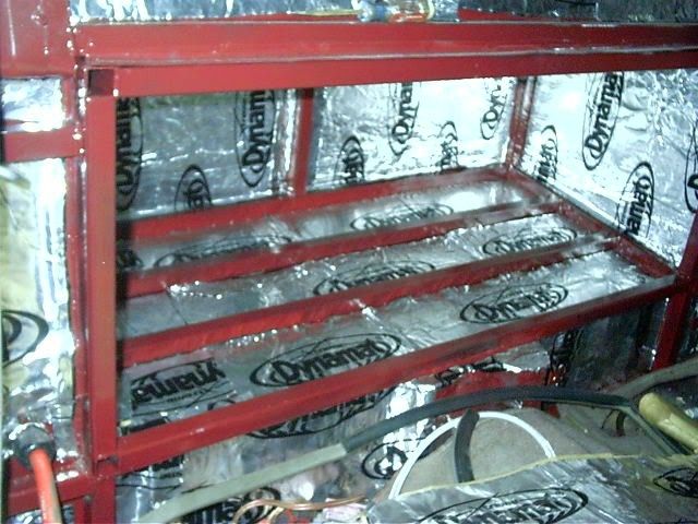

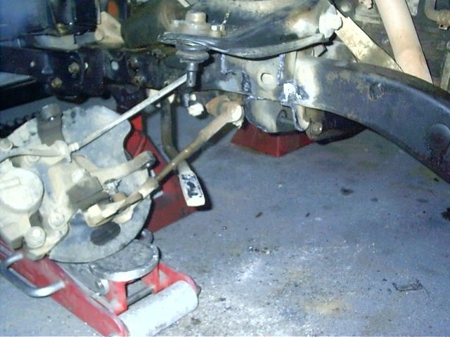

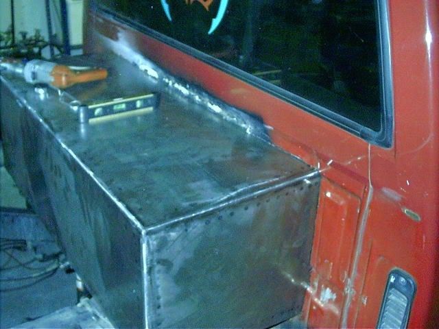

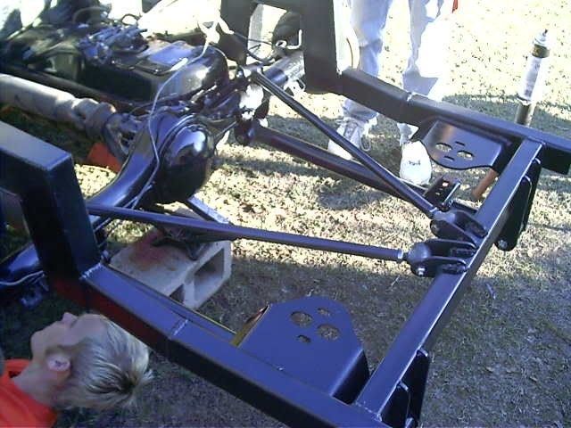

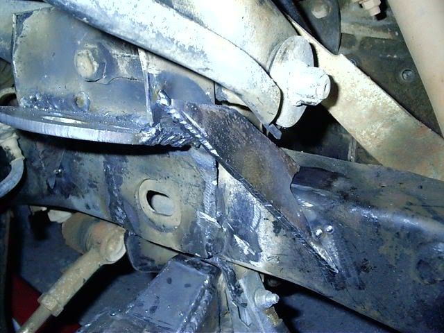

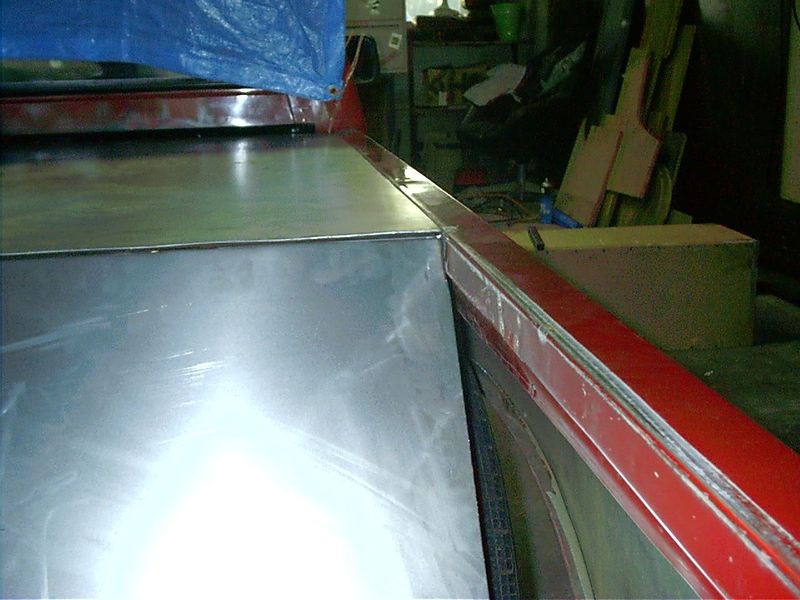

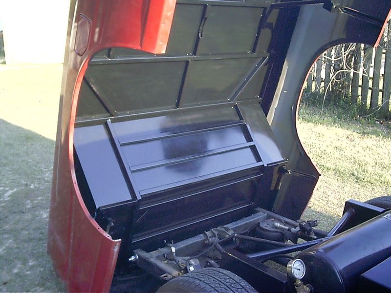

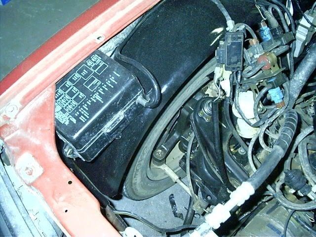

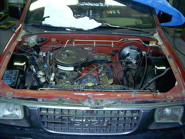

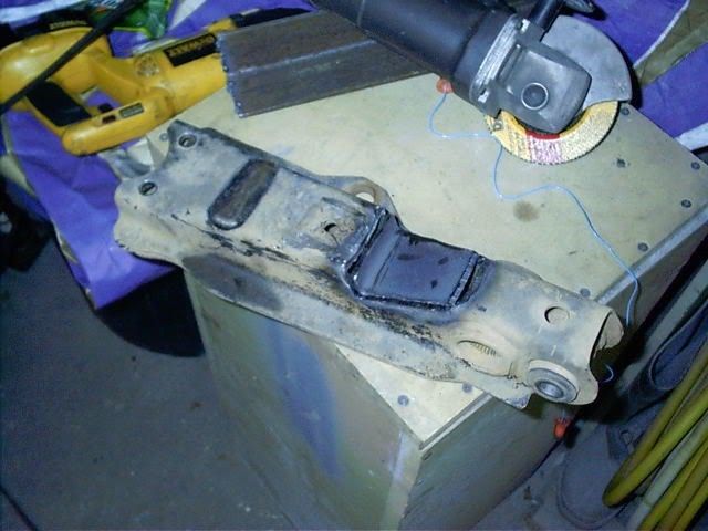

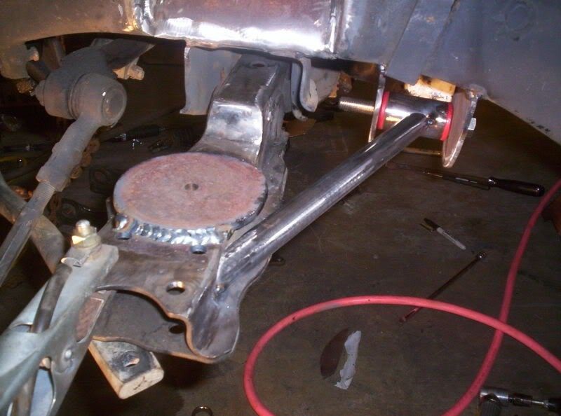

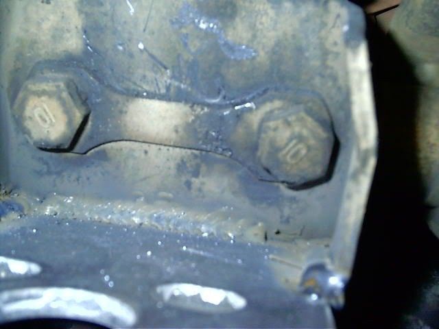

Since i could never find any good pictures of what people do for there isuzus layin 20"s and up, i just went ahead and did it and took a million pictures for anybody that has to do it in the future. Hope this helps alot of ppl out.

Hope that helps alot of people out, I looked around alot on here and coulnt find any pictures so i thaught i would be the one to get some good pictures out there

good post. this looks almost exactly how I did my front end. Only I notched the frame rail and not the LCA. Ultimatly it doesnt matter because the ball joints prevent the front from laying out any further. My lca and frame rail dont make contact, its the damn ball joint that stops the front now. Time to swap to the 88+ spindles I guess.

yeah iv seen pix of people modding the upper controll arm but the owner of the truck dont think it will be stong enough so im not gonna do it. but hes got some 2 in drop spindles on the way, supposidly thats all you need to lay on 20's
