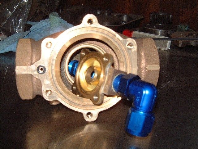

Whats a typical valve orifice size?
Dragin Dakota's avatar
Dragin Dakota
1/2" or 15mm is pretty standard right now. I think that 1/2" fills and 3/8" dumps (10mm) is a pretty good combo.
periportfd
Parker 1/2" ports and either 1/2" or 5/8" orifice. I get 5/8".
bdroppeddak's avatar
bdroppeddak
5/8" is the goin rate for most valves in the market now.
periportfd
Yeah Cris, I think the other guy is confusing port and orifice. The orifice is the area pictured here with the parker valve sticking in it.
no1lowr's avatar
no1lowr
if you go parker go 3/8 port 5/8 orifice, you wont lose a damn instant in speed, plus you can throw sand in parkers!
