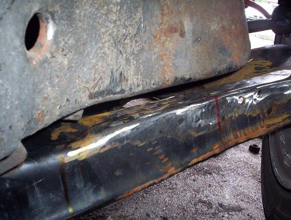

i would notch the frame before the control arms

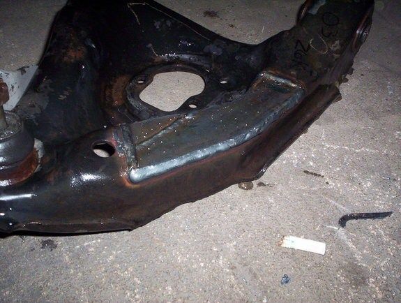

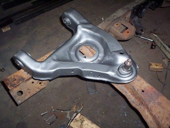

notching the frame just means extending the spring pocket cut, and it gets to be a little excessive. I had notched lowers on my truck. All my pics were lost with the s10 forum gallery though. But yeah, u basically cut off the high spot in the arm so its all flat. Make a template to fit the hole, then cut some plate and weld it in. You can do a quick job in an hour, or take a bit more time and grind it all smooth and metalwork em to look nice. I always weld from the top, and on the inside as well.
mindlissmetalfab's avatar
mindlissmetalfab
Found some pics on s10 forum. from Layinbody31's truck:
He notched the lowers on the side too, so the shock could be moved in for more turning radius.
