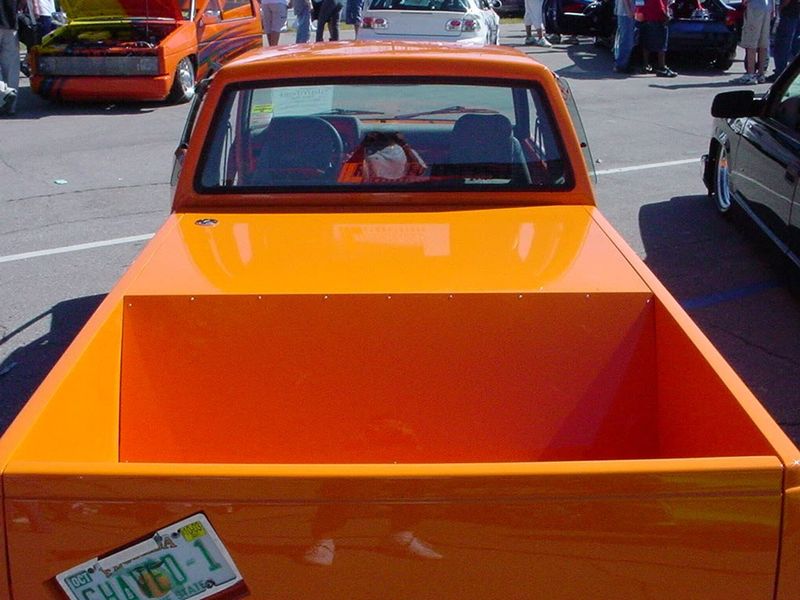

if u dont want to weld the sheetmetal in u cold use the 3M metal bonding adhesive. It will hold with no problem plus you wont have to worry about the metal wrapping. As for the sagging between the ribs that wasnt a problem for mine & i used my bed. OH & the back section of my bed was one piece bent to fit. sux this it the best pic i have lol
