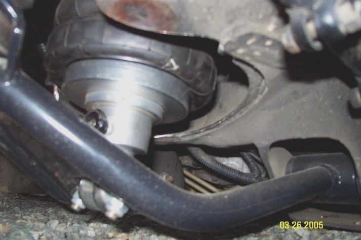

I got the ones from AirRide..double adjustable shocks. 12 positions each for "bound" and "rebound"...super nice, i got my front end dailed in with the bags at 100 psi, got me where i only needed about an 1 inch of travel on the front of my truck for most normal driving, bug bumps or potholes it would still make the tires buzz...but most of all they are the shiznet!! although they are like 300 a peice...if you are going for ultimate ride they are the best...and you do not have to have a shockwave to get these, they sell them seperately if you call
here is the shockwave

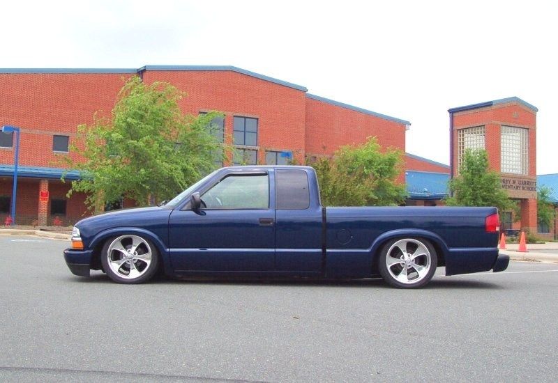

here is rideheight vs. all down
Stock Sucks's avatar
Stock Sucks
no mucho travel...but not needed with these, and AirRide used to use QA-1s, but these are actual a different brand...starts with an A i think like Anderson...i would give em a call..ridetech.com
