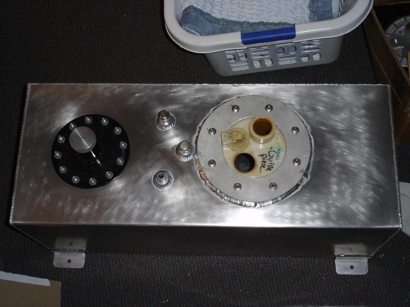

I have 2002 doge ram singl cab that I have recently bagged. I am at the point that I am ready to relocate the gas tankand I have a few ideas. But I would like to see what people are doin for this isuue. Any info or pics would help

i made one and used a spacer and clamp ring to hold down my stock pump.

i did this for me. you would need to get some spacer rings cut and welded to get yours to work.

is you cell under the truck or in the and if its in the bed what did you do for the fuel lines. The reason I ask is my fuel cell has to go in the bed or maybe dosnt have to but at this time I dont have the equipment or time right now to rebuild the fuel tank crossmember.

mine is lke 6" up into the bed behind the axle. the lines come off the top of the pump then down the side of the rails to the hardline up front where the gas tank was orig.

how did you reconnect the fuel lines or did you not have to cut them

the plan is to use the stock plastic barbed fittings nd cut the original tubing off and slide some rubber Fi line over em.
