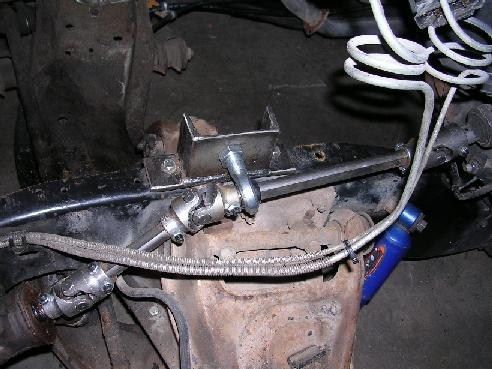

heres a pic of my 85 they are pretty much the same

speedwaymotors.com sells a steering heim joint that fits over the 3/4" steering shaft.
I have some pics of a Zd frame and sectioned lower frame on my website in the projects page(86 chevy)
