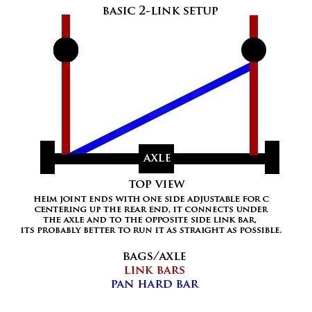

the more straight the bar is the better, but i run mine from the middle of the passenger side link bar to the axle on the other side. here si a diagram.

rail it, thats not a diagram or description of a panhard bar, thats a diagonal link bar. different but they do the same job basically.
each has its pros and cons.
