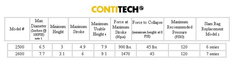

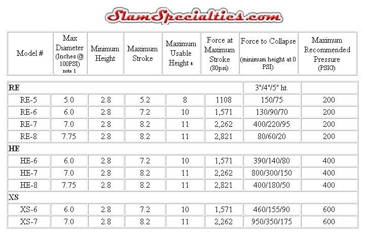

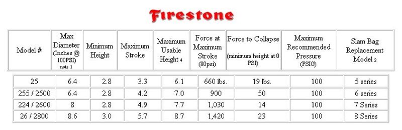

What's the compression size difference between a normal bag, and the triple bellows?
TC29720
The height of a triple bellow bag is 5" collapsed. I'm believe the collapsed on a regular is 3 to 3.5". I haven't had to measure one in a while so someone may be able to give youa more exact number, but I know the triple is 5
whynotfab's avatar
whynotfab
These charts show regular bag's compressed sizes:
The Universal Air 15" Triple Play bags are: 4.5" compressed, 15.75" extended5.875" diameter
Contitech triple bellow 2800s are: 5" compressed, 22" extended.
