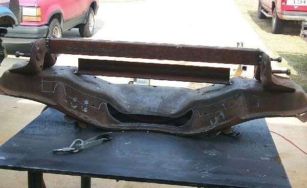

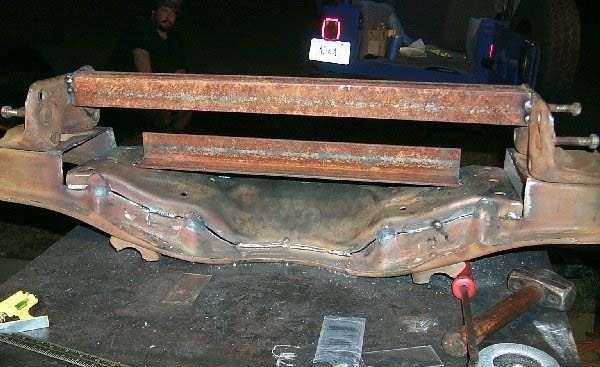

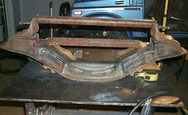

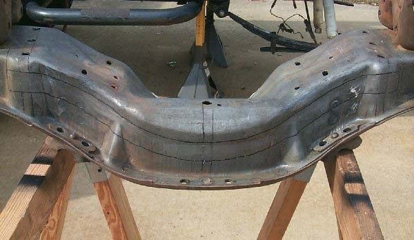

Section the crossmember.
Section it 2" and you will lay flat out, and the crossmember won't hit the ground. You also retain oil pan space. Just turn your welder up and weld it on both sides. Box it where you feel necessary.
