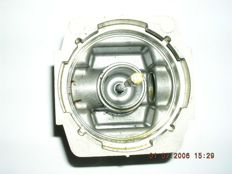

STOP using your EDC right now.Your filters IN and OUT ports are reversed.Below is what the inside of that filter looks like,
See how the incoming water and oil are pressed to the inside of the
filter element?What this does is the oil/water has no where to go so it will clog up the
air passage to a point of hydro lock. This after extended use can build
EXTENSIVE pressure in the line although your gauge will read as little as
110PSI the line between the trap and the EDC will be s high as 550PSI at
this point you will either snap a rod seize the compressor blow the line
blow a head bolt or worse cause serious damage to yourself or truck.
The proper orientation for this filter should look like this,
With the oil and water going to the bowl and the clean air going out to
the tank.
Good news there is a simple fix,
Simply remove your filter flip it around so the port that says IN is now

After talking with SMC ALL AFM Filters and AF filters are setup wrong. So please look at the inside of your filter, if you see this on the IN port,
and this inside,
You filter is in WRONG, and needs flipped around.

i checked mine again and the IN port looks like a cylinder inside the same color and material as the rest of the water trap, the OUT port has that brass looking threaded bolt seen in your pictures....so im assuming that mine is setup correctly.....

Yup yours is correct!!,
