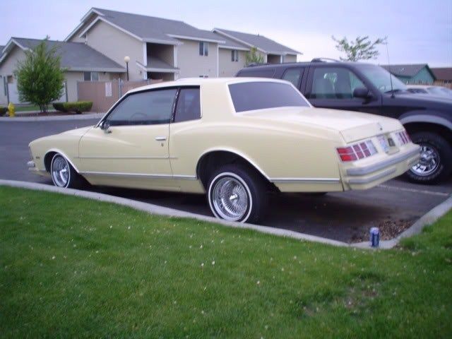

I think you mean G-body any ways I have a 79 monte that I used S-10 bag cups up front and the back I built a upper cup with tabs off the sides to bolt them securely and on the axle I welded a piece of C channel with a stud like you would to mount a power ball for hydros if you have any more questions I'll try my best to help.
