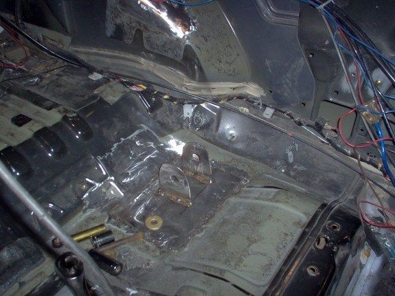

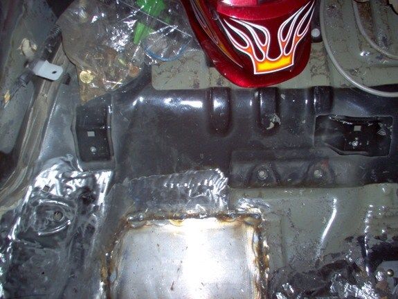

I got the car into school finally and this is what i cam eup with so far
Just gotta finish up the brakes tomm and then start on the cantilever setup in the back seat.

what are the upper bracket for? are you convertin it to dual arms or what?
madmike
for the upper control arms

Yea those upper mounts are for the upper control arms.

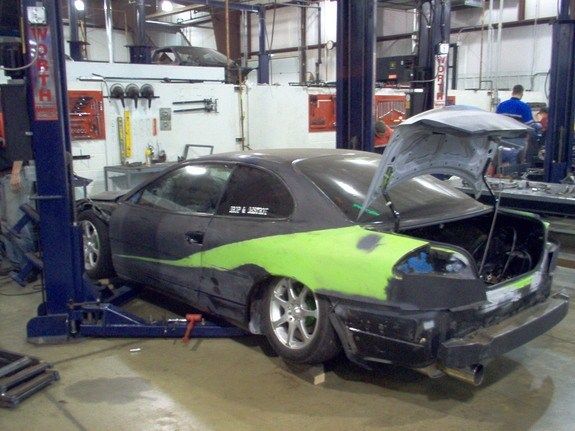

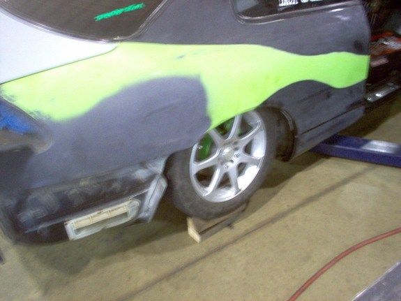

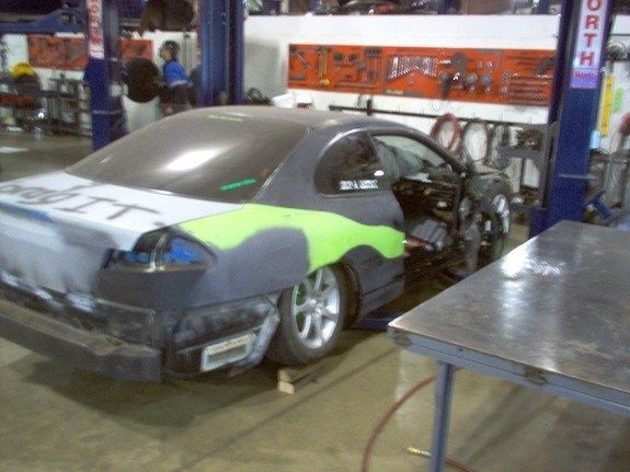

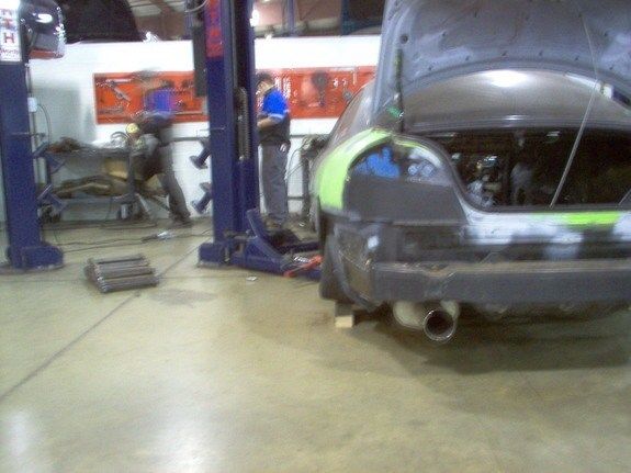

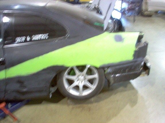

Heres some from today
And its finally layin body. Its got some helaciour camber now and the tire is hittin the control arm mount so im gonna shorten the lower control arm n lenghten the trailin arm so i can ride with it down. Started measuring for the cantilever setup today too

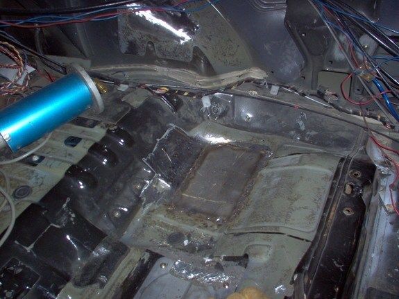

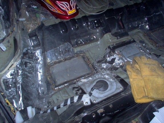

Got the plates welded in today for the lower cylinder mounts and everything measured for the canilever

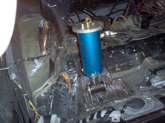

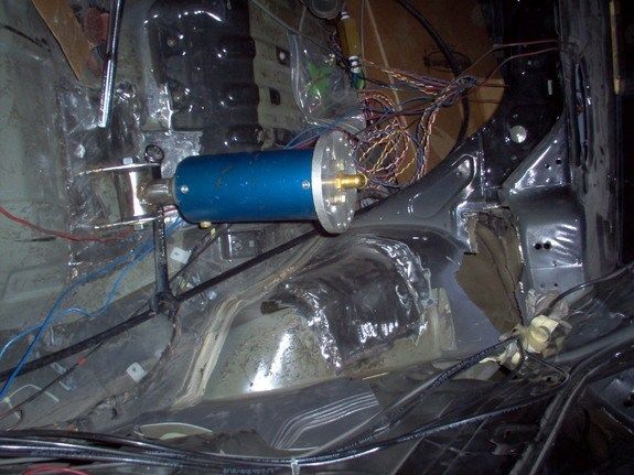

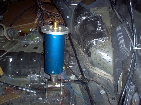

Got the cylinders mounted and braced the wheel wells for the pivot points today
