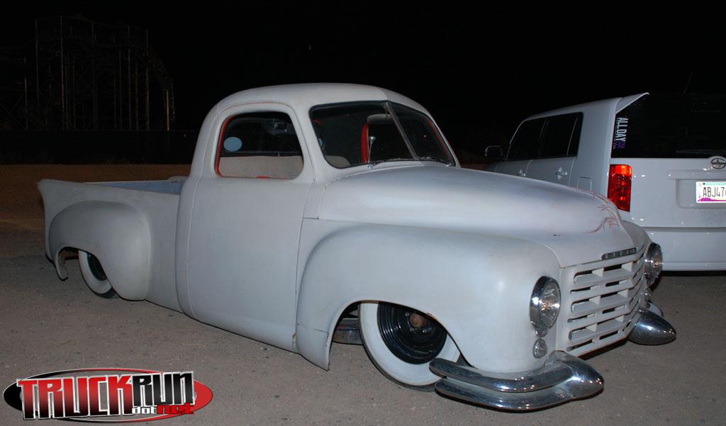

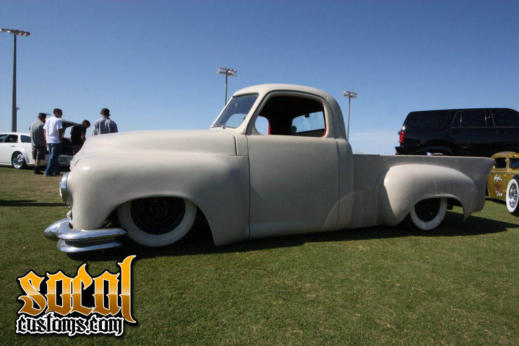

SoCalCustoms shot from show day
Truckrun from Rollin Night
More to come as it moves along
